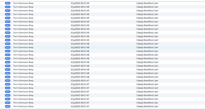

That worked. Not sure if it's supposed to be spamming the message but it is.
This
Yielded this
I see the response information displays on the "form submitted popup". Nice.
Oops. That's what I was thinking of.
I figured this out.
I had an "onSubmitActionPerformed" event running this code:
self.getSibling("Form").submit(preventInvalid=True)
I then checked the property "submit.fireSubmissionEvent" and had it run a form submission.
The end result is it endlessly executes the form submission. The solution was to take out the "onSubmitActionPerformed" code because that event was endlessly causing it to trigger the form submission event.
