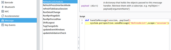

  1. wherever in script libary status is updating there I am calling message handler like below

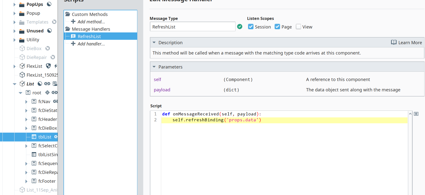

Below is inherited view with message handler
am I missing any step here?
In the child project, the RefreshList message handler needs to be a Session Message Handler, that will rebroad cast the message any view or components message handlers in the project.
Essentially, you need an additional message handler that listens for the message sent from the tag change event, and then rebroadcasts it using system.perspective.sendMessage() to the RefreshList message handler. Just as @ryan.white said above.
how to do it, can please tell me, I am not sure on session message handler.
@lrose, you need to add scope='session' to the function call, otherwise it will not work. The value defaults to page, which requires a pageId, which won't be available in the message handler.

Do we need to call the session message handler in project library?
As I created session handler with name ‘updatelistschedule’ and table component message handler is ‘RefreshList‘.
which one will be in the project scrip libarary?
The project library should reference the Session Message Handler.
In the future, you can add additional messages to be 'refreshed' to just be called from the message handler, and if you get really fancy you can send the message handler name in the payload to the Session message handler, so that you can dynamically broadcast to any message handler in the session.
got it, let me try this.

Might be a wording thing with the manual, but the payload argument is not listed as optional on system.perspective.sendMessage. Try changing your call in the Perspective session message handler to include an empty dict for the payload.

empty dict got missed at one place, now it is working ..
