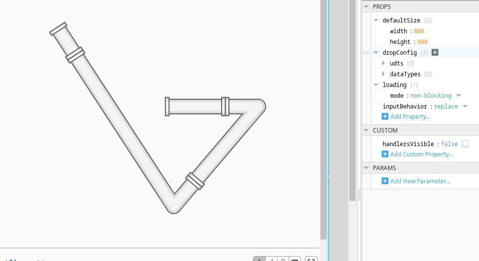

in regards to the “move with arrow” problem.
might be a cumbersome and somewhat silly workaround but:
  • binding a label used as a “handle” to the pipes X/Y coordinates lets you move the label and in effect the pipe using keyboard arrows
  • would obviously have to create a “handle” for each part of the pipe
    • but might be a possibility to create some sort of template here
    • global hide/show for label “handlers” etc..
    • template “handlerView” adding a param “pipeIndex” (and maybe end = "origin" | "conn0").
