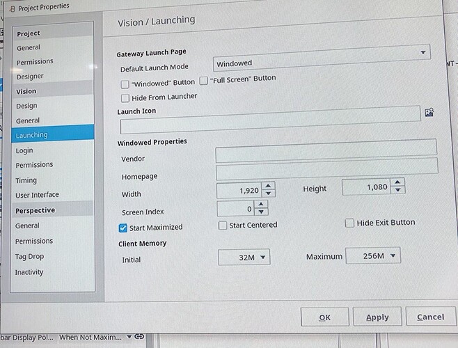

Also, I checked project properties and this is what I saw:
Also, intrestingly, when I add the “[system]Client/User/CurrentWindow” to a text box, I can read the current window name when I launch the project. But somehow I get value None when I use system.nav.getCurrentWindow(). So not sure which one is correct
