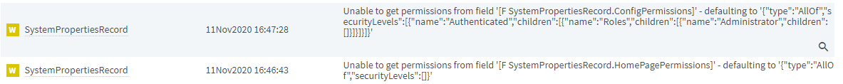

After upgrading from 8.0.14 to 8.1, I’m having some trouble opening and using the designer. However, these problems only happen when I’m trying to use the designer on any device other than the host machine.
Everything works up until I’ve entered my credentials and opened a project. The launcher hangs up on the "Starting module: Perspective..." message until I either forcibly close it or wait it out for ~15 minutes. After that, the designer launches, but my mouse cursor constantly shows as loading. The performance of the designer is poor, and none of the Perspective resources can be viewed, as they fail to deserialize and consequently time out.
I also tried opening a new blank project, but the same issues occur while not on the host.
I’ve inspected the logs while this has occurred, and there are dozens of the top SystemPropertiesRecord warning and a few of the bottom warning:
Again, these problems only occur when not using the host machine. What’s going on, and is there a way to fix it?
Thanks!
Those warnings seem to suggest that the gateway is unable to read the config page and home page security level permissions from the general security settings stored in the internal DB for some reason, and are falling back to their default values (Administrator role required for config page, unrestricted access for the Home Page). What values are stored in the ConfigPermissions and HomePagePermissions columns of the lone row in the SysProps table? Maybe something went wrong during upgrade, though it is not immediately clear to me how that is related to the slow designer connection issue…
Both values are nulls, which explains the logger warnings I posted. It seems this is a tangential problem since it continues logging the SystemPropertiesRecord warnings even when not opening/running the designer.
