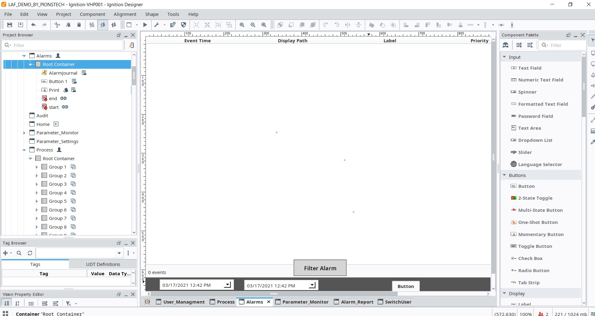

Hello,
I’m trying to filter the alarm journal table using the start and end date selected from the calendar. filter alarm display in the alarm journal table. This problem uses two different windows. The first main window for the alarm journal table and button. when clicking the button then open the popup window. this window selects the start and end date then click the button. Then filter the alarm and display the first window alarm journal table.

This is my main window for the alarm journal table
This is the popup window used for select start and end date using popup calendar.
start_time and end_time are the calendar componentes?
if true, you have to choose the ‘date’ property, no ‘text’ property
start=event.source.parent.getComponent('start date').date
system.gui.getWindow(“Main_Windows/Alarms”).rootContainer.getComponent(‘AlarmJournal’).startDate=start
Hello,
@lachguerabdallah thank you so much for your suggestion. I tried your solution (choose ‘date’ property) and this is working. Now my problem solve.
Thank you for the fast response, it was really useful for determining what was the best suitable option for my project.
