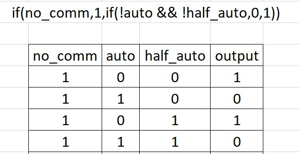

I need do this python code in expression and get 1 (no_comm alway 1 for test) but sometimes I get 0 as result.
python code:
if no_comm:
x=1
else:
if not auto and not half_auto:
x=0
else
x=1
return x
in expression:
if(no_comm,1,if(!auto && !half_auto,0,1))

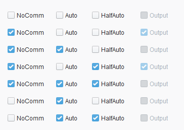

table of variables and output of expression:
What is a wrong this expression?
Thanks.

Hi,
I fixed python code (it’s for idea, thanks), the main question is what the problem with this expression?
I must check half_auto because it’s another opc tag in the system.
if auto and half_auto equals 0 so I need return 0 (it’s for alarm)
no_comm check connection, so I must check connection before display alarm.
Thanks.
Hi,
I don’t speak about python.
please look at the expression code.
Thanks.

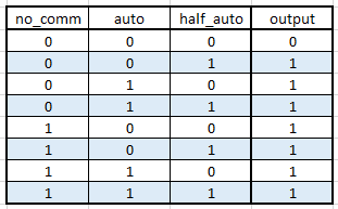

Based on the expression you have here is the full truth table. Let me know what outputs you’re looking for.

row | no_comm | auto | half_auto | x
0 | 0 | 0 | 0 | 0
1 | 0 | 0 | 1 | 1
2 | 0 | 1 | 0 | 1
3 | 0 | 1 | 1 | 1
4 | 1 | 0 | 0 | 1
5 | 1 | 0 | 1 | 1
6 | 1 | 1 | 0 | 1
7 | 1 | 1 | 1 | 1
So, I’d say that, if both truth tables match and the truth table layout matches what you’re looking for (still need confirmation of that), then it should be okay-- although it could be shortened to
no_comm || auto || half_auto
Let me know if the table is correct, or what rows should be different.
