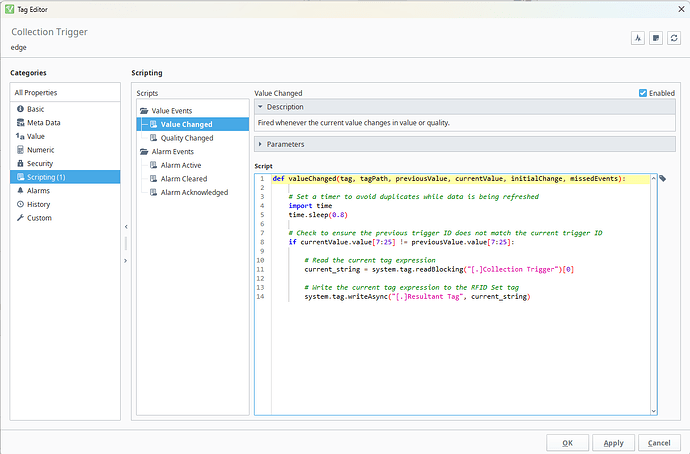

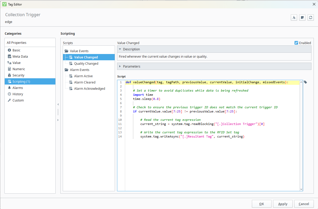

To control write timing:
  • I added an onChange script to each source tag that increments a memory tag (Collection Trigger).
  • When the trigger reaches the expected count (i.e., number of JSON fields), a script reads all tags and writes a final JSON string to the output tag.
This reduced the frequency of writes but failed when one or more tag values didn't actually change (i.e., no onChange fired), causing the count to never reach its threshold and blocking output entirely, so I scrapped this setting.
To mitigate duplicates and race conditions:
  • I used a delayed onChange approach where the expression tag only writes to the output memory tag if the serial number in the current value is different from the previous value.
This method improved consistency but still led to occasional mismatches or stale values depending on tag refresh timing.

Didn’t fully understand the advice since I'm new to the platform, but after digging into the scripting docs this morning, it finally clicked. Just wanted to follow up and share how I got it working in case it helps someone else.
I went with an onChange script since the serial number tag update is my trigger. When that happens, I use system.opc.readValues inside the Collection Trigger tag to pull raw data from the PLC.
Here’s an example of the solution I implemented using Kevin's advice:
