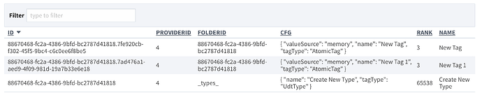

For future reference, does creation of udts always create a _types_ folder in the tagconfig db or no? It seemed like it did to our exploration
No. The _types_ folder is something that we implement in memory and it automatically gets provisioned in memory when a Tag Provider is started. Ignition creates a record with the FOLDERID column containing a value of _types_ without the folder record existing.
Example of a UDT I created to test this. These are the only records that exist for this provider:
