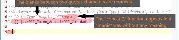

I have updated Ignition 7.9.9 to Ignition 8.0.6 and an expression has been corrupted as follows:
First, in the comments, the blanks between two quotes characters are removed.
The “concat ()” function appears in a “magic” way without any meaning.

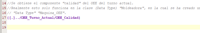

Ignition 7:
Ignition 8:

Thanks for reporting, I’ve made a ticket to track this.
Thank you.
For posterity, the 8.0.8 nightly build available today contains a change that should prevent the issue described in this thread on upgrade.
Ok. Thank you.
