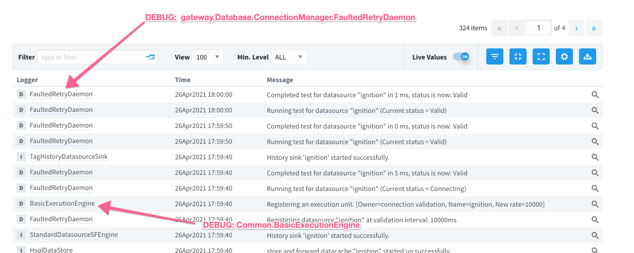

All the Docker stuff above is immaterial to the issue, but I wanted to share for those who might find it interesting. Ultimately, I was able to see the same “stuck” behavior with the DB connection, including the inability for it to go back to Valid on its own. It also seems to apply to other DB connection types as well… I’m opening a ticket to investigate further.
It seems that this may currently manifest from editing an existing DB connection, which seems to be causing the connection validation task to be unregistered. You can see the executions occurring (and the registration and unregistration of tasks) by enabling DEBUG against the Common.BasicExecutionEngine and gateway.Database.ConnectionManager.FaultedRetryDaemon loggers:
You should see the tests running every 10 seconds by default, like shown above.
The workaround at the moment is to delete and re-create the DB connection; alternatively, a gateway restart should also re-initialize the connection properly.
This has been fixed in the 8.1.5 release.
