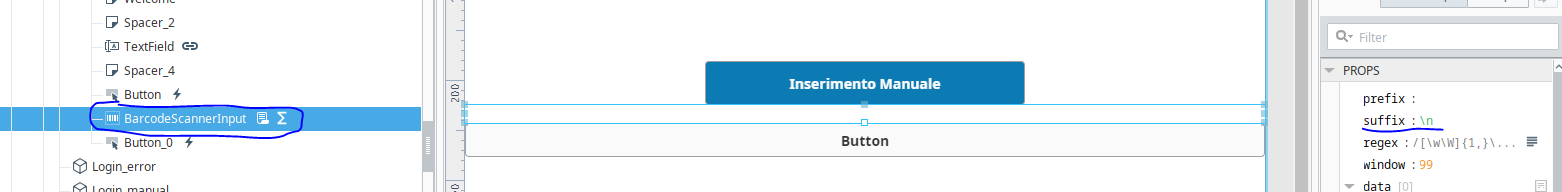

I’m trying to make the BarcodeScannerInput component to read barcode data that ends with a “line feed” character (\n):
I tried different ways:
- \n
- \x0A
- \\n
- \cJ
but they won’t work.
The regex I put is: /[\w\W]{1,}\n/g
The Ignition login, when it comes to scan the badge to successfully log in, it does work.
But I can’t make the BarcodeScannerInput to work with escaped characters (with any alphanumeric character it works)
