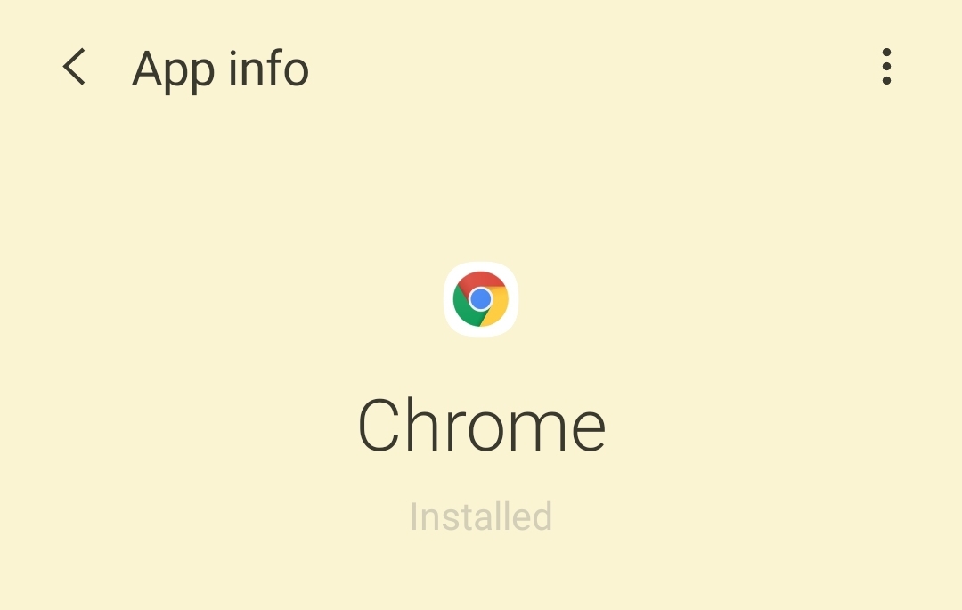

Is the actual browser you’re using Chromium, or based on Chromium? It’s possible that the browser doesn’t haven’t support for Chrome Custom Tabs, which is required for authentication in the app.
That’s all I got, it’s just the chrome browser for Android. I guess I got carried away when I said chromium
