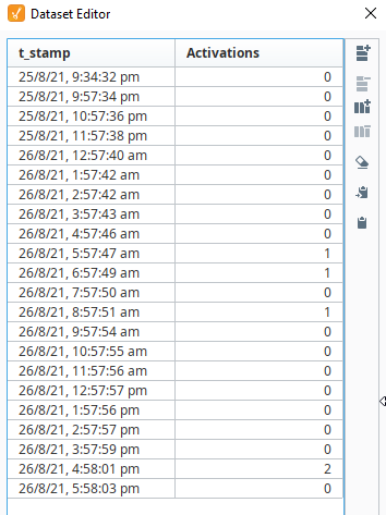

I’m seeing some strange behaviour with a tag history binding. I have the following binding config:
With these dates configured, I get data returned:
Start / End
Data returned:
When I add 1 minute to start datetime, I get no data returned:
Data returned:
This same arrangement worked in previous versions?
Haven’t tested, I just plonked some components onto a View to test something and found this odd behaviour

The dates in the dates pickers were set manually by me via the component calendar popups, so they should be properly set as date times. And I can literally use the time spinner to decrease the time by a minute and the data is pulled in

It seems to not work >= 21:35, despite there being data all the way up to the end date time…

Yep, tried all that as well. Anything before 2021-08-25 21:35 displays data. Anything after it doesn’t :confused:
