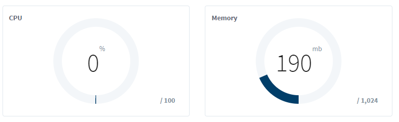

Hello. May I know how can i show the CPU and Memory usage at the client. Is that possible ?
Thanks.
Show the gateway’s CPU and Memory usage on a client?
Yes correct, would like to show the gateway CPU and Memory usage on a client.
There are some system tags that may be what you want
[System]Gateway/Performance/CPU Usage
and
[System]Gateway/Performance/Memory Usage
