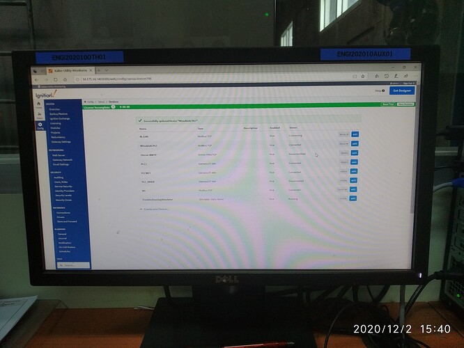

I think it posibble to connect Io link master to ignition. I tried to connect Io-Link IFM AL1340 (Modbus TCP) , and not success. i think only setting ip address and port number. i need suggest to fix ? thx
Welcome to the forum!
Can you please take a screen capture (on windows press {Windows Key} + Shift + S) and upload as an attachment, it is pretty hard to make anything out of your photograph.
You can try going to status section (top left of your image) then Connections/Devices then click Details beside the device that is in error for you. Under log activity change min level to trace.
