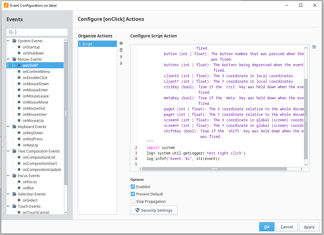

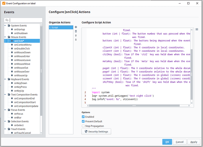

On a label in a view, I configured a “onClick” event with a minimal script (print in console)
and it don’t work, when I click with right button on label it showed popmenu of browser.
I am testing on Firefox (91.0.2) and on Chrome (92.0.4515.15)
Your “Event” is for a standard click, not a right-click. If you want to prevent the context menu, you need to prevent default for onContextMenu.
So “onClick” event work only with left button?
Not exactly. An onContextMenu event is, by definition, what opens the popup menu in the browser. You have to intercept that event type if you want to prevent the default context menu behavior. This is all up to browsers and Javascript, not something Ignition/Perspective came up with:
