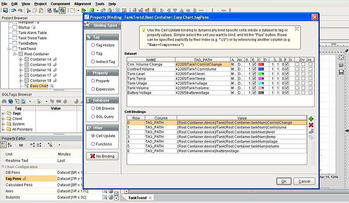

what I have done for similar issues like this is setup the easy chart component like you want for one of the tanks. Then you can go in to the cell update component and reference a dynamic property containing the tank ID on the screens root container. basically if you only need to replace the tank number delete it and link the dynamic property that contains the tank #.

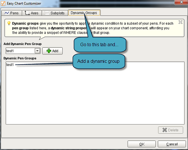

check this out

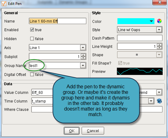

This is from a quick tutorial I was putting together using dynamic groups bound to a value passed into the window upon opening.
PassedOnValue
in this example is our input value. This can really be any sort of string and you can use as many as you need to fully define the dynamic group.

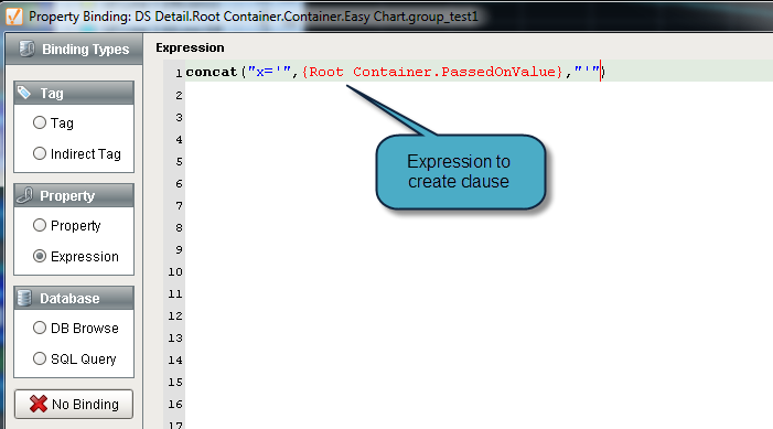

Now, we can go back and bind the group_test1 property to an expression that creates the snippet.

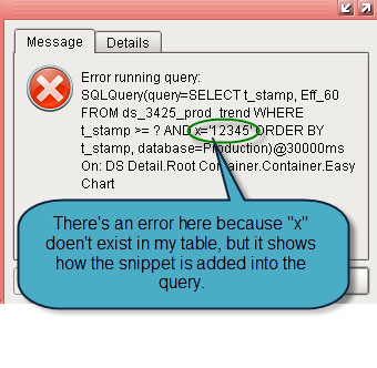

Okay, I’m back!
Hope this helps you out!

BigJoe - I have a feeling that you’re using SQLTag pens, not DB pens. The dynamic groups feature only applies to DB pens, which are for charting history stored in the database via a SQL Bridge historical group or similar, not the SQLTags historian.
The tutorial above is about as clear as it’s going to get for where the WHERE clause snippet goes.
To have a dynamic set of SQLTag pens that get controlled via paremeter passing, you’d alter the tagPens dataset (expert level property of the chart). This is where the cell-update binding might come in handy.
