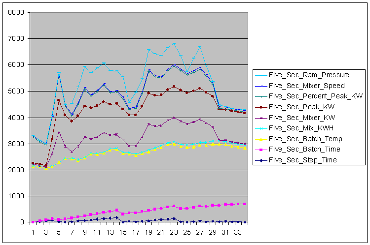

So, here is the real question, using the chart in FPMI, do i graph this data if all the t_stamps are the same? I also capture BATCH TIME, which is going to change and this gives me a better idea of WHEN the information in EACH row of the SQL database is, but if i try to use that for my x axis, it doesn’t work, i would assume because the slider at the bottom of the chart if utilized for DATETIME, not BIGINT.

Just to Clarify what I’m looking at, here is an Excel file with two BATCHES captured.
as you will see, the t_stamps for batch 50’s data are all the same, then it changes for batch 51 to the NEXT captured t_stamp.

If you block transfer the data in using a block group, then you’ll get all of your 5-second data as rows in the table with the same timestamp, the same blockid, and different row ids, right? I think you can use the row id to manipulate the timestamps in MySQL. Logically, you want the following manipulation for each timestamp:
timestamp - ((# of rows - rowid)*5sec)
This manipulation (which you can do in a SQL Query or View) will let you use block transfers, and still treat the data as if it had 5-second separated timestamps.

My idea is to use your PLC registers like a queue for FactorySQL. The PLC will prompt the “array read” and “data massaging” groups to run. After the PC read, the PLC clears that data, and (figuratively) puts the new data in the old position. On the DB side, FSQL gets the data into a format that the EasyChart can use. Here’s a conceptual sketch:
  1. You would add a delta column to your array that maintains cumulative elapsed time in ms since the last batch read. The first row will always have a zero in this column. The second may be 8ms, the third 17ms, the fourth 26ms, etc.
  2. Suppose we choose to read 50 records at a time with our FSQL block transfer group. You would either use another array, or have a much larger one in the PLC. Let’s use the example of actually having 200 elements in our array.
As soon as the PLC has logged 50 elements it notes the delta[50] time (relative time to log 50 values). It then energizes the trigger, prompting FSQL to do a batch read. The PLC is continuing to log values until FactorySQL resets the trigger or sets a handshake bit.
Suppose the PLC has logged to the 72nd row when FSQL indicates successful receipt. The PLC then moves those 22 rows to the first position, subtracts delta[50] from their delta times, and continues logging at the 23rd position.
There may be a more efficient way of implementing this with pointers or indirect addressing, but get it working first.
  1. Add a second datetime column, derivedTStamp, to your table. It should be indexed, allowed to be NULL, and default to NULL. At the end of each batch (use a separate trigger), a different FSQL group will run a query that calculates this value. In pseudo-SQL it’ll look something like this:
UPDATE table SET derivedTStamp=datesubtract(t_stamp DURATION delta milliseconds) WHERE derivedTStamp IS NULL
Keep in mind that FactorySQL will set the t_stamp value to the current datetime of the array read, which is your 50th value. The delta value is that logging offset.
  1. Create the FSQL group like how I described above. The triggering is a little different. Instead of running every 5 seconds while the trigger is true, it should run once when the trigger is true then reset the trigger (or set a handshake bit) - the PLC is running the timing. Also, make your array as “long” as is reasonably possible and performs well. This will take some tinkering.
It’s a little tough to wrap your mind around, but I think it’ll work well. Does the approach make sense?

how would i use that statement? lets say i have all my data in a table. within that table, every batch has 60 rows. i’m using a block group in fsql, so i have a blockid. all the timestamps are the same for x blockid for 60 rows. Now, i do a query in fpmi on a Table component.
SO, heres the question, i want to graph the data, how do i manipulate the t_stamp and create another dataset or what ever YOU have in mind to achieve the trend?
I meant to use your database’s built-in date manipulation (date arithmetic) functions directly in the SQL query that creates the DataSet that drives the chart. For example, for MySQL the function you could use is DATE_SUB to manipulate the timestamp, subtracting 5 seconds for each block, thus getting logically accurate date information.
