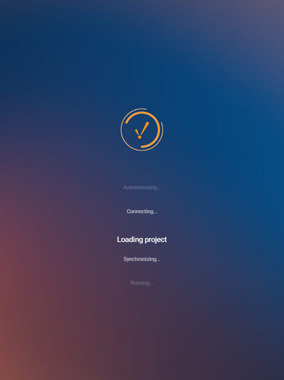

Hi,
I use the perspective app on an Android tablet.
I have made an application that requires a lot of scrolling in the application.
When you scroll and reach the end of the page and you continue scrolling, the application will reload (see image).
Is there a way to make sure that the application is not loaded again when scrolling / swiping?
Thank you
