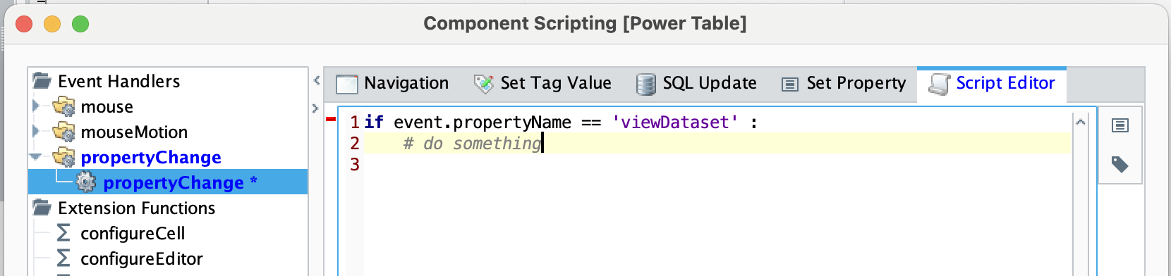

Hi @ltoscano,
When you sort a column in a Power Table you apply a change to his ViewDataset property.
If you filter the property name in the propertyChange event handler, you will be notified that the viewDataset has been changed
Hope this helps,
have a nice day
