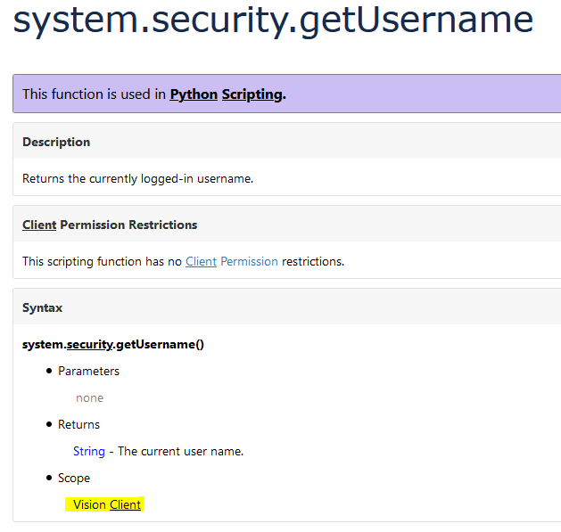

I was viewing the documentation for system.security.getUsername() and saw one of the examples called this function in the Startup script. I tried using it in Update (when a user saves the designer) but I get the following error in the logs.
com.inductiveautomation.ignition.common.script.JythonExecException: Traceback (most recent call last): File "<[] Update Script>", line 4, in AttributeError: 'com.inductiveautomation.ignition.common.script.Imm' object has no attribute 'getUsername'

Is there something Im doing wrong? Is there a different way of getting the username of the user who saved their environment?
You’re using a client-scope function in a gateway script.
Yeah that makes sense. Thank you. Do you know of a function that can accomplish this goal in a gateway script?
The gateway can run without a logged in user, or with many logged in users, so that function wouldn’t make a lot of sense.
