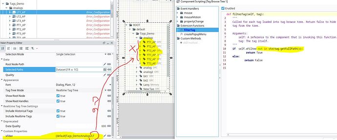

Hello, I’m new to using Ignition - Vision and I would like to know if there is a way to do the opposite of this script, instead of writing all the folders that I don’t want to show, I would like to write /filter only the one I want. That is, in the property I created xFiltro, write the name of the folder that should be shown, because I have 50 folders, imagine writing them all…
Thanks in advance for your help.
replace the True with False and visa versa xd
or add a not in front of the in
Thanks @victordcq ,but didin’t work.
Then you probably got something wrong else where, because adjusting one of those things littlerly makes it opposite xd
show me your code
You have to be careful here with your filtering.
This:
if self.xfilter in str(tag.getFullPath()):
    return True
else:
    return False
Is logically and functionally equivalent to:
if sefl.xfilter not in str(tag.getFullPath()):
    return False
else:
    return True
If both cases if the filter is in the tag path it will return True. You can only switch the logic in one place or the other.
The key here is you need to return False for any tag which should be hidden in the tree. I would tend to write it this way:
    return True
return False
This suggests that self isn’t what you think it is, and thus self.xfilter is not what you’re expecting.
try this and see what prints out in the console:
print type(self)
if self.xfilter in str(tag.getFullTagPath()):
    return True
return False
