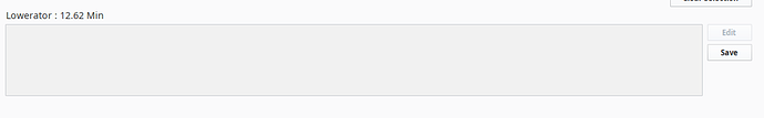

I would like my users to be able to add notes through a text field, and also format the notes/parts of the note if needed(like adding bullet points, or changing color of selected text), then click a “save” button which will write to a tag called “downtimeNotesLine1” (datatype: Dataset) that saves the notes. Similarly, I also have tags for other Lines.

Yes, I am using the reporting module. Also my use case is to reporting supervisor notes on largely accumulated downtimes throughout the shift (not the individual downtimes themselves)
My question is if there’s any way we could implement a MS word style formatting option on text field? Or if anyone has attempted to do so.
There is a markdown component. You could bind that with a textarea i guess.
