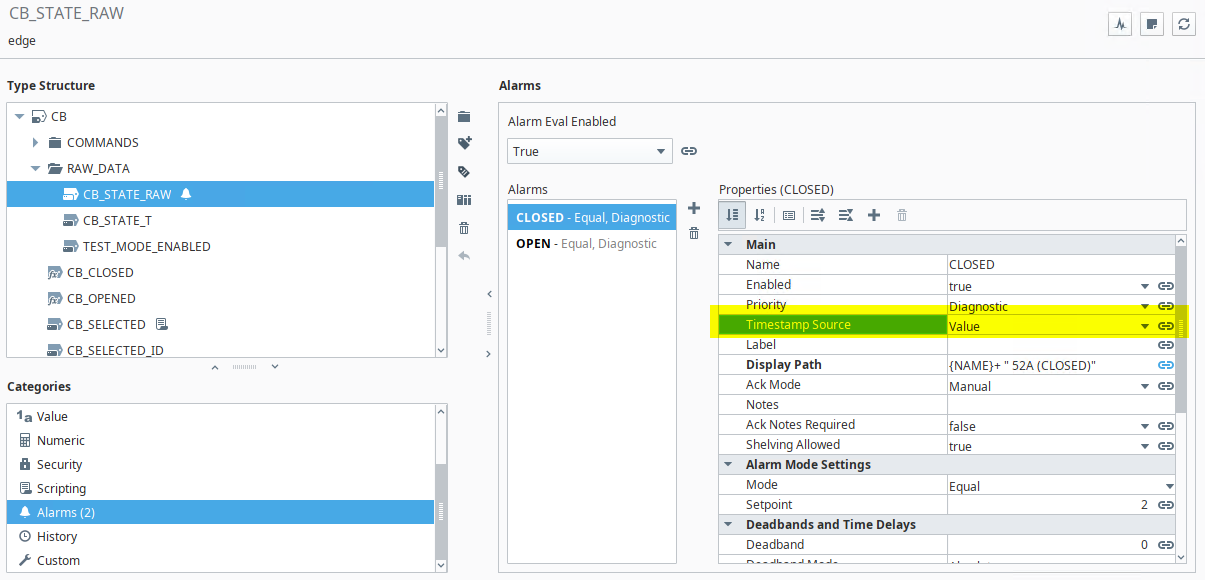

IEC 61850 alarm time
You can set the Alarm Timestamp source, and ensure that you are also subscribed to the relevent _t tag.
eg: subscribe to the following:
  • {BUFFERED REPORT PATH}.PRO_BK1XCBR1.Pos.stVal
  • {BUFFERED REPORT PATH}.PRO_BK1XCBR1.Pos.t
