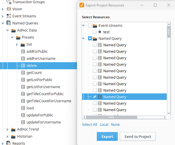

  • Exporting Named Queries all show the same generic name in export list

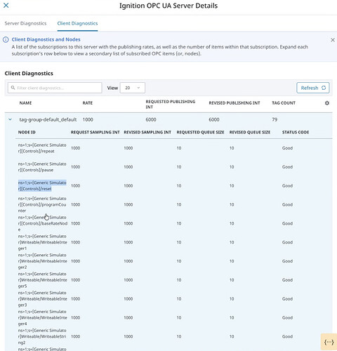

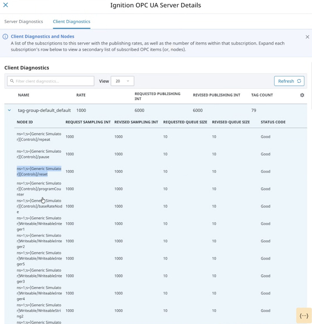

  • OPC-UA Client Diagnostics tag/node list needs to be wider and paginated for better performance with large tag counts - having 60k tags brings the browser to its knees

Yeah, this is on an imported project, but when selecting a named query from the tree and trying to export, I get this.

Thanks - it's an easy fix; we'll get it taken care of.

@michael.flagler Were you referring to this part of the gateway in this comment above?
Yes, I'm not on a system where I can grab a screenshot right now, but the tags wrapping "feels" messy, and when you have a large number of tags (we have many systems with over 50k tags) and without it paginated and only pulling a portion of the tags, the browser starts crawling and essentially becomes useless I believe from the amount of data it's trying to load.
Definitely, I see what you mean. We will get a ticket in to have Design look at improving that experience.
I wonder how it goes with 400k tags… :face_with_hand_over_mouth:
I can't even imagine. I've used it in the past to see what tags are in an error state without opening designer, but lately I just use the tag report tool to grab a list that I can export. Still would be nice to just be able to sort by status to see at a glance if there's any bad tags. Maybe a filter on this page to only show tags that are in various states or even any that aren't good.
