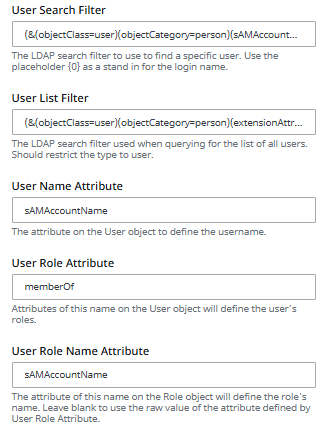

With a standard upgrade we found these initial issues:
AD User source added ""s in the Search Base, Role Search Base fields. Nothing resolved until the "s were removed. (Solved)

Were these previously empty and they became "" instead?
The fields before upgrade were not empty. They had functional and correct values. It seems the upgrade itself added the quote marks.

Note the quotation marks around the whole thing. Those weren't there initially when this was imported and I had to add them to even get this far.
Huh, that's interesting. And there's another post where somebody's AD config gained some quotation marks that they had to remove...
Looks like the quote is part of the filename it's attempting to use.
Same somebodys Jay and I work together. We were complaining about that up this thread.

Hi Jesse,
I had a similar issue while upgrading my test environment from 8.1 to 8.3-beta. The autentication with the AD user source worked well on 8.1 but in 8.3 the "User Role Name Attribute" had been changed from "cn" to "sAMAccountName". That leads to the problem that the user roles cannot be fetched anymore. The even more strange thing is, that I cannot change the "User Role Name Attribute" back to "cn" as this will automatically change the "User Name Attribute" field. In our case that results in the sitatuation that we are not able to use AD user sources anymore.
BluegelMarius -
I will take a look at this. If you have a gateway backup that you are willing to send me, that might expedite the process.
BluegelMarius -
I took a quick look at the edit AD panel in the Web UI, and there is a bug where it maps both the user name attribute and the user role name attribute to the same field. I will open a ticket for this issue.
In the mean time, you can use the OpenAPI doc to learn how to send the command to update the user source directly, with your favorite HTTP client:
  • http://<YOUR_HOST>:<YOUR_PORT>/openapi
You need to be authenticated to view the OpenAPI doc. You can search for modify user sources or navigate to config user source and expand it to find the modify doc.

I should also ask, what was the state of the settings for the AD user source immediately after migration? Due to the WebUI bug, you would need to look at the config directly, by doing one of the following:
  • Use the OpenAPI doc mentioned in my previous comment.
  • Look at the payload when you load the edit user source panel in the WebUI using developer tools.
  • Look at the user resource on disk (home/data/config/resources/core/ignition/user-source/<PROFILE_NAME>/config.json)
Do the settings look right using one of those methods immediately after doing a migration?
Jesse,
I restored the backup and performed the upgrade again. I checked the user source config right after the upgrade and it seems like all parameters are correctly set. "groupRoleAttribute": "memberOf" and "roleNameAttribute": "cn". Still I was not able to Log in as the gateway was not able to fetch the roles. I did some more testing and I found that if I set "emailAttribute": "memberOf", I can fetch all roles into the email Attribute but if I do the same on the "groupRoleAttribute" it will get an empty list.
