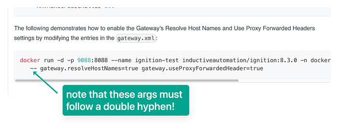

If it is sitting behind an Ingress, you'll probably want to:
  1. Configure your public address settings in Ignition.
  2. Supply gateway.useProxyForwardedHeader=true gateway arg after reading this.
Number 2 there will bridge the gap of communicating to Ignition that you're terminating TLS upstream.
Bonus: the Helm Chart we're working on will make it relatively easy to use the same Secret that is linked to your Ingress for TLS termination with the Gateway web server for end-to-end encryption without a lot of setup headaches. Stay tuned!

        command: >
           -- gateway.resolveHostNames=false gateway.useProxyForwardedHeader=true

Issues when Auto Detect HTTP Address is enabled behind a TLS-terminating reverse proxy are being tracked in IGN-15058 - that ticket has not yet been resolved.
The current workaround remains to disable Auto Detect HTTP Address and manually set the Public Address, HTTP Port, and HTTPS port settings.
As @kcollins highlighted, if you happen to be using the Helm chart you'll get that config out of the box. If you aren't, there are a few ways to set those:
  1. Directly on the Gateway Webserver config page
  2. Using the container runtime options -a, -h, and -s (note you must use all three). EG:
-a  ignition.k8s.localtest.me  -h  80  -s  443
