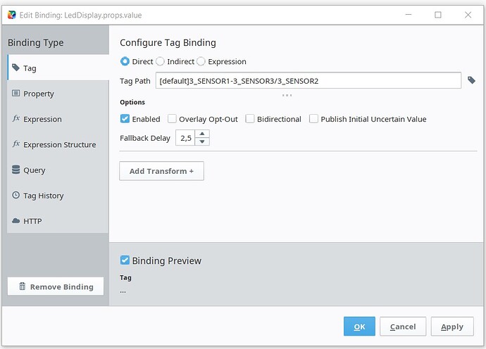

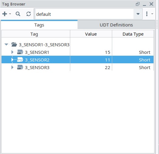

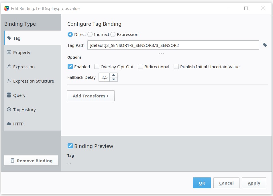

Hi everyone,
I’m new to Ignition and encountering a frustrating issue for 2 days: whenever I drag and drop a tag onto a viewer and choose any component (like LED Display, Tank, vessel, Gauge…), it does not show the tag value, nothing happens.
What I’ve checked so far:
• The Tag Browser shows the tag value and quality “Good”, coming from my OPC device.
• The binding is created correctly: I see the binding icon is active (blue) and the tag path is correct.
• The problem occurs with all type of component, so it’s not just the LED Display.
• No error overlay or red indicator on the component, even though the binding is active.
I’m attaching three screenshots:
  1. Tag Browser showing a working tags.
  2. The LED Display and its binding properties in the designer.
  3. Full screenshot.
    Has anyone experienced this before or can suggest what might be misconfigured?
    Appreciate any help.
Are there any errors in the designer console? Also, your main view appears to be in preview mode, what happens if you exit and re-enter preview mode?
The Binding Preview isn't showing a value. What happens if you put your cursor over the "...":
Can you get a thread dump from the gateway, also?
Could it be an issue resolving the "-" in the tag path? Try a simpler folder name with no special chracters.

As you can see from the attached screenshots, I'm doing what you suggested, unfortunately the problem still persists.
Kind regards.
Fallback Delay should say "2.5" not "2,5"
EDIT: That's probably just a glitch in the resolution of the screenshot. I can't get it to say that, it changes to "25"
But I'm still wondering why your Binding Preview just says "..." and you haven't said what its tooltip says.

I'm trying to click on the dots, but nothing happens; it doesn't react. I think, since the component doesn't load the tag's value, the binding preview can't show any value. Thanks for the effort, dear Ryan.

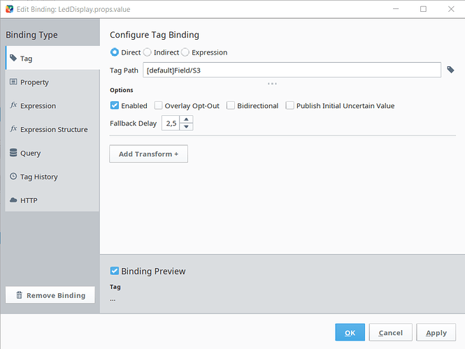

Sorry for the delay in getting back to you. Please find attached a screenshot of the test you suggested: I created a Numeric Entry Field linked to an LED Display using a property binding, and it works fine. So internal bindings in Perspective are working, and the issue seems to be only with the tag bindings. Tag bindings are actually what matters most to me, and I absolutely need to solve this issue in order to continue my SCADA project.

Wait! The binding preview dots are not made to be clicked, but just hovered over with the mouse (to see a popup tool tip). Please try again.
Hello everyone,
The binding issue I mentioned earlier is still persisting. I followed the previous suggestions, and internal property bindings work fine, but tag bindings still do not function.
At this point, I am considering reinstalling Ignition to see if this resolves the problem.
