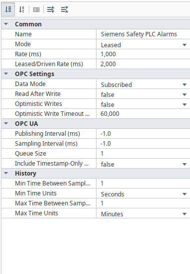

I have a siemens and rockwell PLC connected to an 8.3 Beta 4 SCADA and i have seperate tag groups setup for the siemens and rockwell plc tags.
For some reason a significant portion of the siemens PLC tags are in error with the error code:
Error("CreateMonitoredItems failed: Bad_InternalError: An internal error occurred as a result of a programming or configuration error.")
These tags are UDTs and if i change the tag group to any tag group apart from the one defined in the UDT the error sometimes goes away
Also most of the time i have the tag group in the UDT set to something different to the main one these tags appear to work.

Are you certain each member instance in the UDT has the correct tag group? I had a similar issue when one member within the UDT had a tag group that did not exist. Each atomic member of the UDT can have different tag groups assigned, and not beholden to the UDT tag group.
Yes i am, and in case the binding was creating some weridness i’ve also set overriden the instance and set the tag group manually to “Siemens Safety PLC” same error.
As soon as I set the tag group to another group if the tag is going to start working it does. This is inconsistent though
