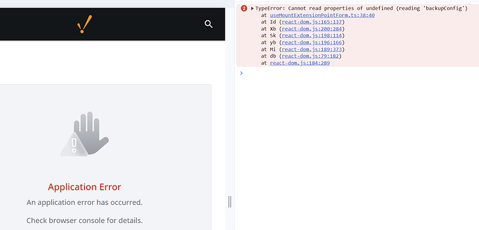

I’m trying to create a custom historian provider.
Where can I find the historian profile config?

In the Create Historian popup, my custom historian is not selectable and when I click Next, it gives an application error.

I'm guessing that there's an issue with your SimulatorExtensionPoint, or SchemaUtil.fromType(####.class) wasn't actually SchemaUtil.fromType(HistorianProvider.class) as it needs to be.
I’ve added the HistorianProvider.class
Still getting the error though.
react-dom.js:121 TypeError: Cannot read properties of undefined (reading 'backupConfig')
at useMountExtensionPointForm.ts:38:40
at Id (react-dom.js:165:137)
at Xb (react-dom.js:200:284)
at Sk (react-dom.js:198:114)
at yb (react-dom.js:196:166)
at Mi (react-dom.js:189:373)
at db (react-dom.js:79:182)
at react-dom.js:184:289
@Override
public List<? extends ExtensionPoint<?>> getExtensionPoints() {
    SimulatorHistorianExtensionPoint sep = new SimulatorHistorianExtensionPoint();
    return List.of(sep);
Thank you for bringing this to our attention, Jae.
We have confirmed this is a bug related to how default values are handled within the extension point resource form on the Historian page.
Currently, we're targeting this for the upcoming final release, but if it doesn't make that deadline, then it will be included in 8.3.1. I will update you on our progress.
