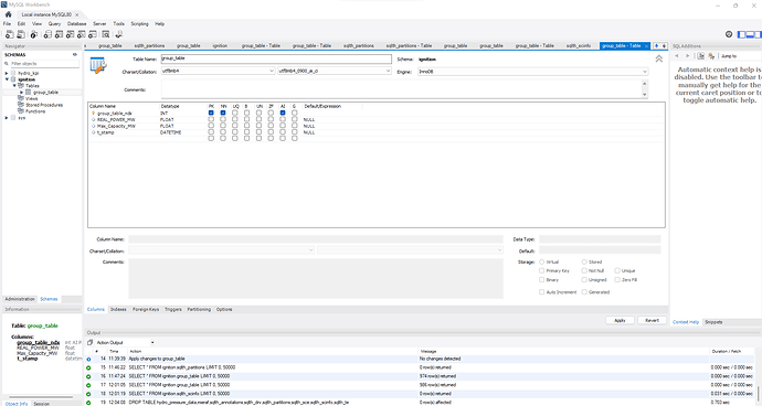

Thanks, that helps. The problem is that the 'column size' being returned for at least one of the columns in that table is being returned as null, and due to a bug on our side we're not protecting against that.
Can you show what your table data types look like in MySQL Workbench? We can absolutely reproduce it and fix it either way - just as a point of curiosity.
The JDBC specification for the function we're ultimately using says this:
The COLUMN_SIZE column specifies the column size for the given column. For numeric data, this is the maximum precision. For character data, this is the length in characters. For datetime datatypes, this is the length in characters of the String representation (assuming the maximum allowed precision of the fractional seconds component). For binary data, this is the length in bytes. For the ROWID datatype, this is the length in bytes. Null is returned for data types where the column size is not applicable.
So I'm interested in which of your columns might be causing us issues.
