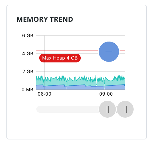

Would a sparkline work better here for the memory usage instead of a pie chart? If the purpose is to provide reflect the current health of the system, a sparkline would be able to show the sawtooth pattern (or lack of).
You have that available on the Performance page: /app/diagnostics/performance
The field in question is meant to be a “quick” indicator as opposed to the more in-depth chart.
I am aware of the one on the diagnostics page, but I was thinking one even simpler for the performance overview. Just enough to show the general shape of the memory trend, no axis, no gridlines.
I guess this gets into the challenge of the simplest way to articulate the system status, with minimal screen space available.
It really does. The Overview page with the indicator in question is really just meant to be an at-a-glance page and charts really require a more devoted, concentrated effort to fully understand what you’re being shown. Our designs focused in part on keeping complex UI out of the Overview pages.
