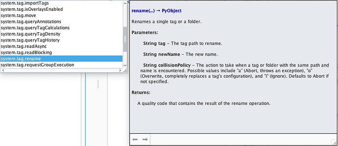

This does look like a bug. I’ll log a ticket so that we can look into it further.
system.tag.rename() was added in 8.0.2 when functionality was split out from system.tag.move(). As far as I know, it’s not deprecated, but it might be missing some documentation in the manual (I’m looking in to this also). You should still see it in the designer UI:
It looks like a better solution in this scenario.
It looks like the original issue was that system.tag.getConfiguration is outputting the dateTime value in a format that system.tag.Configure doesn’t accept. If it’s converted back to milliseconds before writing it back in, the issue no longer occurs. I’ve updated the post title with the ticket number created for this issue.

I’ll give rename a shot. The absence from the documentation put me off using it
Understood, this has been corrected. Thank you for bringing it to our attention.
