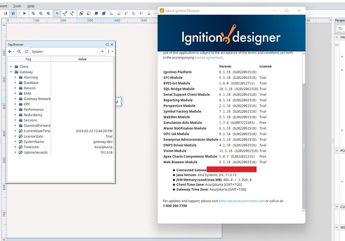

[IGN-6087] Perspective - DateTime Input - Incorrect day is displayed when selecting in the DateTime Input
Summary
Steps to Reproduce
  1. Add a DateTime Input component on the view

I've tried to recreate this on 8.1.25 - not successful. Maybe it was fixed.
Using 8.1.18 as depicted above, but I was also unable to reproduce this error. I also search the 2022 and 2023 change logs, and there was no mention of this.
I believe you are running into a known bug that occurs in specific timezones. Could you try testing with a timezone outside of the UTC - 6:00 to UTC + 14:00 range? If that works, then it confirms you're running into this bug.
