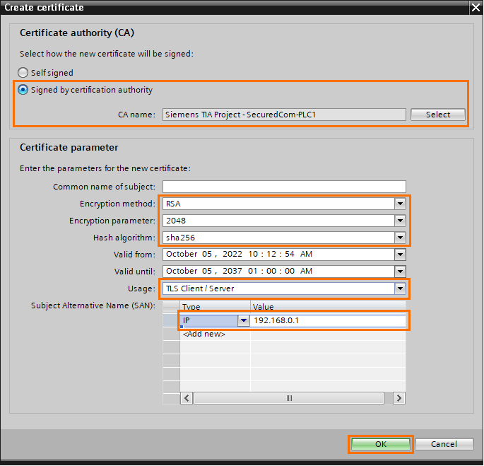

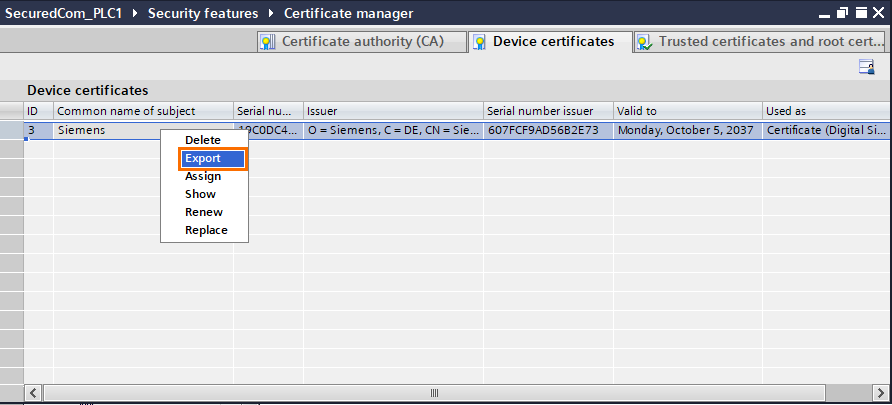

HI @Kevin.Herron ,
do you have any guide or any suggestion on how implement the “certificate” communication with Siemens PLC? A couple of my customer are asking to test this kind of comm.Thank you in advance, Andrea
You don't need to do anything on the Ignition side, the driver connects with security by default, and falls back to attempting an unsecured connection if that doesn't work.
Thank you Kevin! I was not aware of this “native” behaviour of S7+ driver on Igniiton. I’ll share those info with the customer and if necessary I’ll be back. They were talking something about “.pem” certificate to Export from the PLC, so I was thinking there was something to import on Ignition side:
