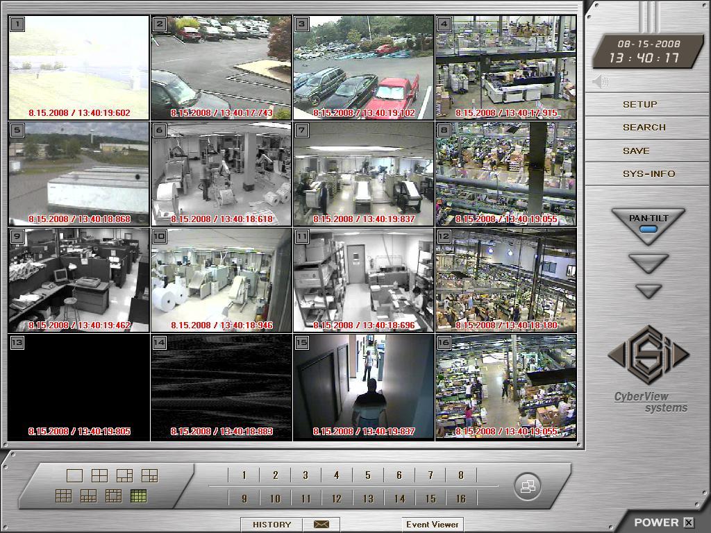

Here is a screen shot of the camera system software screen. The software is by a company Cyber Systems Inc The cameras are Panasonic and ???.
I would contact CyberView Systems tech support and ask them for the URL format for the MJPEG streams of the cameras.
