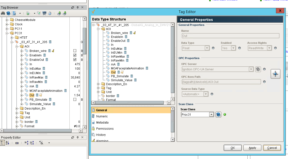

Scan Classes are important on large installs. Group each set of PLC tags in its own scan class. Use a ‘driven’ scan class on tags that do not need to be scanned all the time. Driven has two rates, fast and slow determined by a tag. I usually use a tag that is TRUE when on a particular screen to scan the tags at the fast rate, and set the tag to FALSE on screen exit to scan the tags at the slower rate. Window Open and Window Close events are used to SET/RESET this tag.

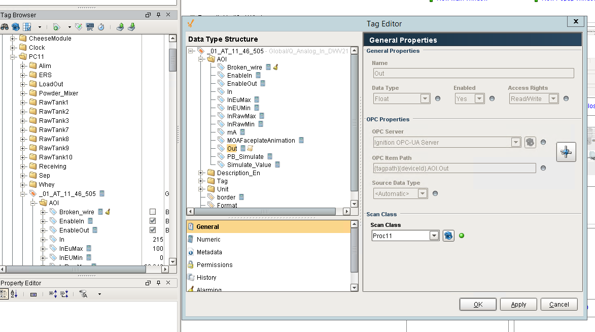

Tags grouped into folders according to processor,
Each Processor has its own scan class

When I started my first large install and was having communication and response time errors, this was the recommendation from Inductive Tech Support to group PLCs into separate scan classes.
OK.
It would be nice to hear from some Inductive Tech Support member what's the reason for that... :scratch: :question:
Each scan class it’s a different Thread. If you a have a multi core microprocessor server (todays is common), you make the communicacion load more faster. Also, if you have several tags from differents devices in one scan class and you have communication problems with one device, this could affect the adquisition from the other tags on the good device. Finally, never mix SQL querys tags with OPC tags in one scan class (you are mixing potential database problems with potential communication devices problems).
Summarizing, separating scan class in, at least, one scan class per device, could be more job, but make easy troubleshooting communication problems and in a multi-core server, makes the communication more efficient and faster.
