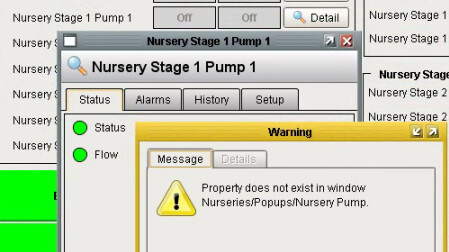

Got a weird problem where I click a popup and I get this warning:
Based on the message and the setup of the popup, it appears to be an issue with the parameter passing but I cant find any issues (well nothing is jumping out). Also with the exception of this warning the popup seems to be working just fine.
Sequence of events:
  1. I click on the “detail” button of this Template with two custom template properties which are UDT’s
  2. The popup launches and is otherwise working but this warning keeps showing up on every instance

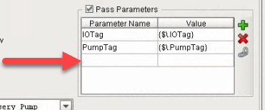

Here is the template showing the template parameters and how they are passed to the popup “Nursery Pump”

If I use the designer to navigate to the popup the warning does not show. It only seems to affect the client.

One thing that seems a little code smelly at least is the fact that you are passing in values for IOTag and Pumptag as parameters, but you also have these properties of bound? Normally paramters aren’t bound since that’s what you want to be passing in.
Under the actionPerformed, what does the code in script editor say? Maybe some designer tried to add another additional parameter to be passed that does not exist in your window.

Thanks bkarabinchak, good advice. :+1:
There was a blank third parameter in the script (code below), it is shown on the GUI but has it had no name and value it did not jump out.
I deleted the parameter and the warning went away.
Not really necessary now but here is the code script showing the blank third parameter:
param1 = event.source.parent.IOTag
param2 = event.source.parent.PumpTag
window = system.nav.openWindow('Nurseries/Popups/Nursery Pump', {'IOTag' : param1, 'PumpTag' : param2, '' : ''})
system.nav.centerWindow(window)
