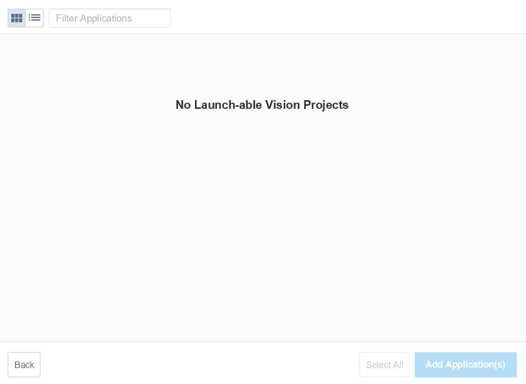

I have the next problem when I try to add new project to Vision Launch.
I have checked the project propertie “Hide From Launcher” and it is disable, I have a main windows to start and the inheritable is disable. The launch project is ok when I start it from the designer.

Is the project itself enabled?

¡SOLUTION!
For any reason, I don’t know, “Hide From Launcher” was activate again, disbale this condition and save. The project function correctly on Vision Client Launcher.
