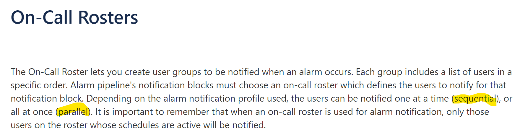

The documentation indicates that there is a way to configure alarm notifications such that users on a roster are notified sequentially or in parallel… Where would I look to find these options?

i asked support this exact question, here's what they said:
The manner that emails are to be sent out will be determined in the design of your alarm pipeline.
When you create an alarm pipeline and utilize the notification block. In finding the Contacts Roster Type property, a Direct roster type will notify all contacts in parallel.
If you'd like to send emails out sequentially you'll need to design this using Calculated Rosters or Delay blocks in combination with the Notification blocks, depending on how you want to handle the sequential notifications.
