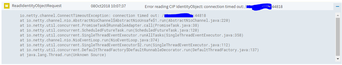

I have CompactLogix (newer than 20) driver that works on one gateway configure identically to a separate gateway attempting to connect from the same host that will not work. It goes from “idle” to “connecting”.
Here is the log from my new gateway:
However this same PLC is connected successfully to a separate gateway using the exact same configuraiton settings…

Sounds like a firewall configuration problem. Can you ping the PLC from the new gateway?
Yes I can ping it, but besides ICMP and 8088 I can’t recall what other ports I have opened on the firewall though. Is there anything specific I should look at?
This is going to get confusing, so I left this out of the initial post, but if I create a duplicate driver with just a different name on the WORKING gateway I get the same issue. If you look at my post history I had questions about a duplicate device so I could configure a project that was using a different version of ladder. I could never get it to work (the duplicate device on the working gateway, working in that at least the original device stays connected on that gateway) because of the exact same issue. This leads me to believe there is a configuration issue or an AB issue but the config settings are identical.
looks like 44818 is probably the culprit, I will report back
yup TCP 44818 needs to be open, should have looked more closely at error message. That is the eth/ip and rslinx critical port for Rockwell. Thanks for spurring me to troubleshoot firewall!
