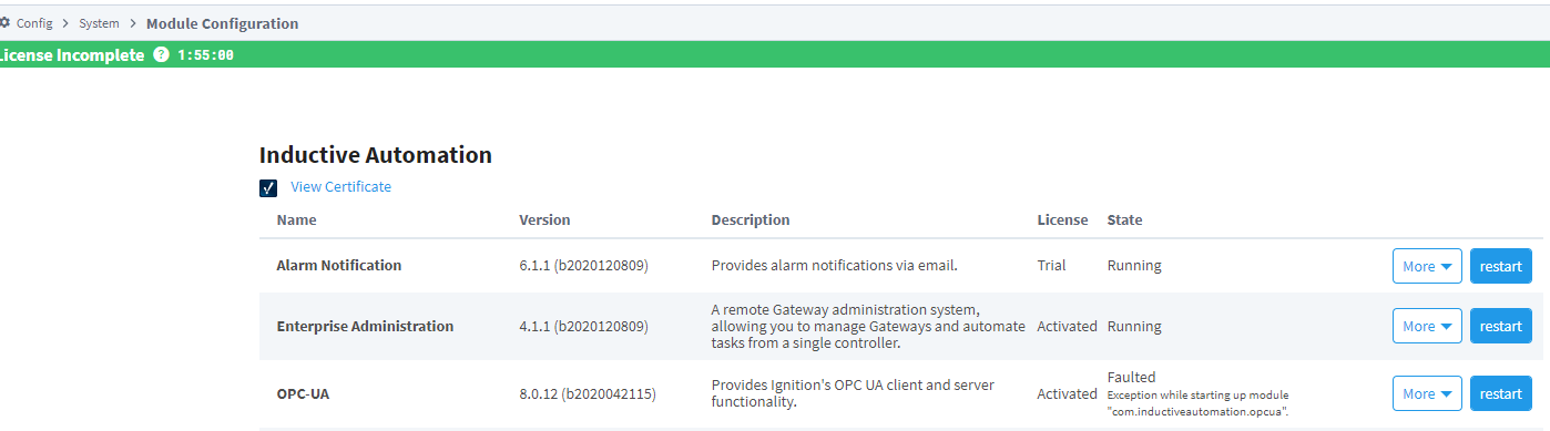

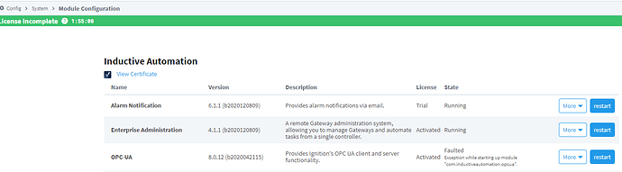

There is an issue for OPC UA module I have to fix for my customer. I notice every time when i restart the PC, OPC UA module is Faulted, it takes 3-5 mins at least to start the services.
There is only one Siemens S7-1500 device configured under OPC UA. I have tried update Ignition version from 8.0.12 to 8.1.1 to 8.1.6. The issue still there. the screen shots and wrapper logs as below.

Something is wrong with your system and is holding the connection to the internal DB open for longer than 30 seconds at a time, which is what caused the OPC UA module startup to fail and caused all the other timeout errors during startup.
You should probably call support to have them look at this with you. I don’t think the problem is with the OPC UA module itself, it just got caught by this other problem.

The log shows that system.device.listDevices() calls in some project script are hogging the internal DB connection.
As a work-around, don’t let that code call listDevices() until the gateway has been running for a couple minutes.
I have remove my tag expression script which calls system.device.listDevices() every second. and the issue is solve.
