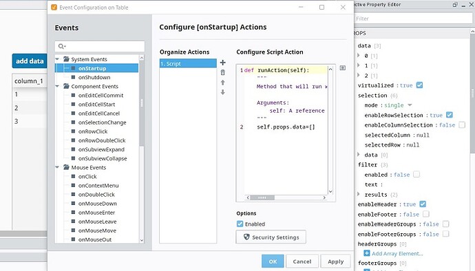

Hi, I would like to erase the content of a table at each refresh of its parent view.
I created this onStartup Event Script on the Table itself, but the data don’t seem to reset on startup.
self.props.data=[]
Any idea what I’m missing here ?
Thanks

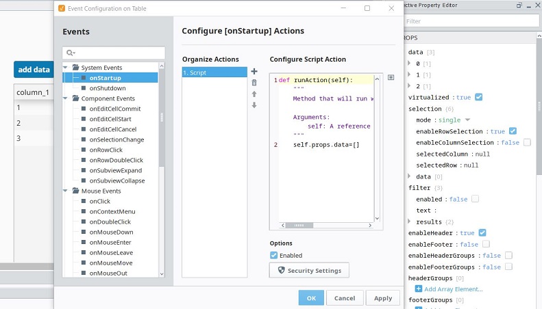

@nminchin I created this custom prop on my view, and attached a 'change event' to it
But I still don't get the table data reset that I'm expected.
