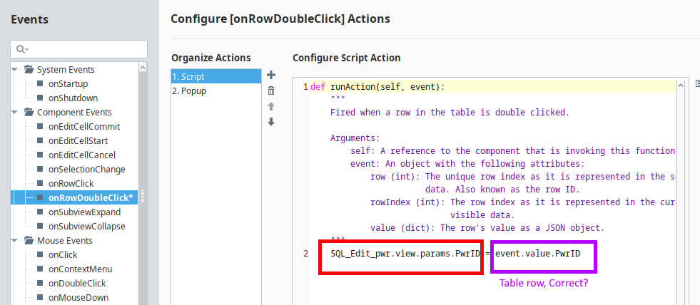

I created a table and retrieved SQL data using Named Queries.
I have created a PopUp window, which opens with a double click on the data set I want to edit, and from here I do not know what to do.
How do I get the right data into the Popup window?
What is the correct method when saving edited data? script or?

Why not use,
Table.props.selection.data
I imagine using the event object provided by the event handler would guarantee that you get the right row, whereas I don’t know if you can guarantee that the selection.data would be updated before the double click event handler is called. I mean, it probably would since the first click should change the selection, but in general, this would be my reasoning to always use what’s provided by the event handler rather than the same properties from outside

The value attribute of the event object is a dictionary, so I think the script you are looking for is:
SQL_Edit_pwr.view.params.PwrID = event.value['PwrID']
Tried that
SQL_Edit_pwr.view.params.PwrID = event.value[‘PwrID’]
and also
SQL_Edit_pwr.view.params.PwrID = 11
None of them give a value in my PopUp field :frowning:
The Log in the Gataway, tells me that “SQL_Edit_pwr” is not a legal global name, so “SQL_Edit_pwr.view.params.PwrID” is not the correct syntax for the PopUp view parameters.
So now I only need to figure out the correct syntax :frowning:
SQL_Edit_pwr isn’t defined anywhere in your script. I’m not sure what this is supposed to be.
So you want to bring up a popup to edit the row data?
Then don’t you want to open the popup on the double click action?
Ah, I see what you’re doing, you have two actions, one to open the popup and one you’re trying to use to pass the values - you have this part wrong. You need to open the popup and pass the params at the same time, via the open popup command. Delete your script action and use the Popup action to pass your params.
Fyi, you can only pass params to a popup via the open popup action or script function (system.perspective.openPopup) at the time you open the popup. You can change custom props in a popup via a few different methods: message handlers, using custom session props, or using tags. But you cannot reference a popup via script to make direct changes to its props. If you could, you wouldn’t simply be able to use the name of the popup as the reference, you would need to call a function to get the reference to it (as you can in Vision)
