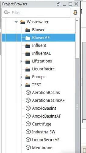

In Ignition 8, I am having an issue where all of my windows in Vision and Perspective will turn into folders that will not open. The only ones that don’t turn into folders are the ones with no tags on them. Please see pictures. I hope I haven’t lost everything.

I sent the backup to Inductive Automation support about a week and a half ago. Waiting for them to come up with a fix. The guy said that it was a known issue.
Unfortunately, there is no real “fix” for this - once the resources have been saved in this state, their content is lost (unless you have scheduled backups or other file rollback available to you). Aside from that, the issue is known and we are working on fixing things so that it no longer occurs as soon as possible (ideally, as soon as 8.0.6)
This issue was fixed in the 8.0.6 nightly build that was uploaded today (10/21).

I also am expierencing the same issue where my "Views" turned into folders on my customers system while trying to update a screen. I also read about this may happen when the Gateway has no more storage which my says "Disk Full". I have a ticket in also so we will see
What version are you running? The OP was an 8.0.x version 4 years ago. Issues in those versions are generally not a problem today in updated systems.
If the gateway has no storage space to work in, all bets are off for behavior in Ignition. Fix that problem first.
