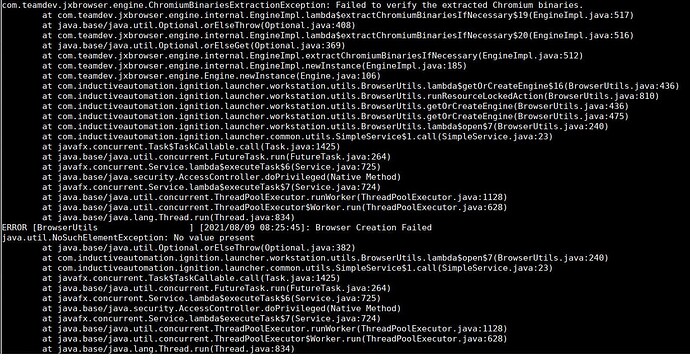

I’m trying to use Perspective Workstation on a managed thin client. The Workstation application works fine, but when I try to launch a Perspective I get this error:
Please help!

What OS is this? Can you copy-paste the full logs here?
We are using Igel OS, which looks to be Mainline Linux.
I’ve attached the full log after a clear and reboot.
Perspective Workstation Error Log.txt (33.3 KB)
I don’t know much about iGel, but the system requirements are published in our docs (links to JXBrowser, the embedded browser library we use)
So, that’s not a tested platform for us, but you might still be able to get things working.
Based on com.teamdev.jxbrowser.engine.ChromiumBinariesExtractionException: Failed to verify the extracted Chromium binaries.
- does the user running the workstation process have ownership over chromiumDir: /userhome/.ignition/cache/resources/jxbrowser/7.12.1
and userDataDir:/userhome/.ignition/clientlauncher-data/workstationUserData/10
I see ownership of the …/7.12.1 folder, but I do not see the second path (…/workstationUserData/10). The only thing I have in clientlauncher-data is:

Thanks Jonathon. Per the requirements, it looks like we are missing JDKFX… working with the vendor to package that into our OS build and I will update after that. I made the assumption that all the Java stuff was bundled in Workstation.
It should be, I don't think that's your issue.
Launching with -Djxbrowser.logging.level=ALL
might help…
It seems we were missing some prerequisites in the OS; including Chrome with the download package fixed it (whereas Chromium did not). I don’t have any more details on what specifically was changed by installing Chrome that made it work, but it consistently installs and runs now.
