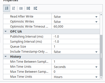

Hello everyone, I encountered the following issue while using PowerChart:
When I clicked to insert a label into a component, a component error was reported in the real-time chart.
When I switch to historical mode, it displays normally. I can see that the historical data for this tag is a straight line, at which point I realized that this data has not changed. So I expanded the legend.
When I switch back to real-time mode, the other data that changes in real-time displays normally, while the data that has not changed shows no corresponding trend data.
I believe the normal display should also be a straight line, right? (In the tag group, I set both real-time and historical tags to save or collect data once per second, as shown in the image.)
This issue occurs quite frequently. How would you suggest resolving it in this situation?
I put my components below.If you need any additional information to help resolve the issue, please let me know.

I just saw where the error is displayed. When you hover the mouse over it, this will be displayed.
Cannot read properties of undefined (reading 'name')
