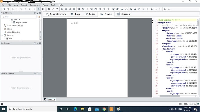

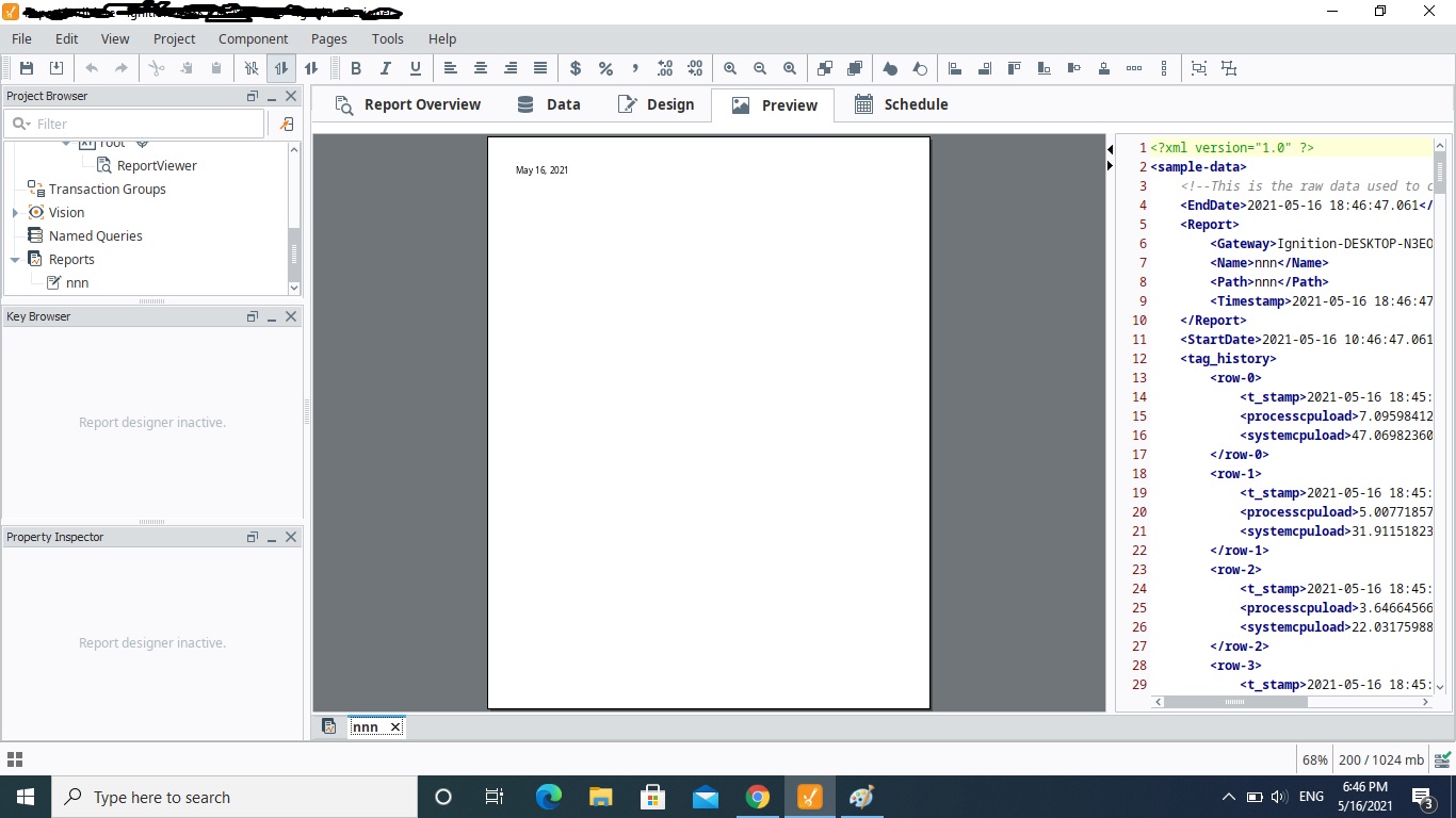

Problem in report didnt appeare value in report
i have problem didnt appeared value
Looks like you might not have put the data key on the table. Check out the docs for how to do that: Data Keys - Ignition User Manual 8.1 - Ignition Documentation
Once you’ve done it, you’ll need to remove the “tag_history.” from the table design.
Thanks so much KathyApplebaum
I didn’t put the data key on table
