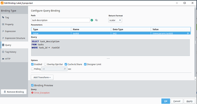

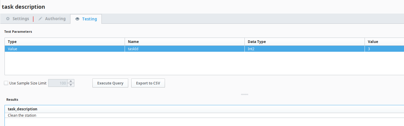

So i have this query that works in the named query section but does not work in perspective
It works here
I also have a similar sql query for the name which works with the same code
See, literally the same code
Can someone help me solve this issue?
what does the error say?
it does not say any error just state the value as null.
I see an error on your screenshot xd
it says task description not found but in the named query there is no problem
task description or task_description ?
this is weird, if there is not named query how do i even select the named query lmao
huh did you rename it? save everything and restart the designer
yeah, it suddenly works lmao
